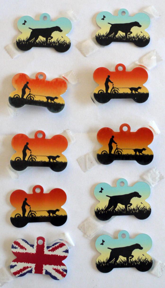

After using the temp gun, and changing the temp on the display to 175C so that the platen was actually at 190C in one spot, I printed a single tag, and it was the best result I'd ever got, the black was actually black instead of mottled brown (from the temp being 15 degrees higher than the display said I presume), but then these 10 tags were all printed at once, and the results vary across all of them, because it's not an even heat
