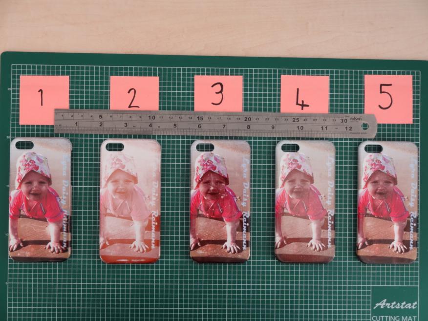

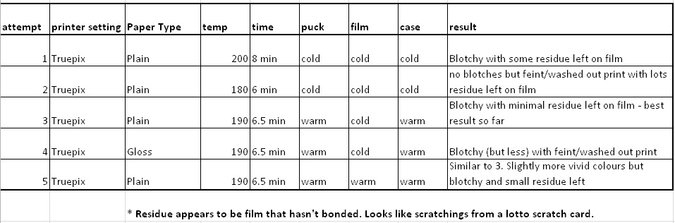

I've literally just started and the quality is not great (I didn't expect it to be right off the bat). I can produce varying results by altering times/temperatures, but I wanted to be sure I was printing correctly before I wasted too much time on the process.

Can you post pictures of the results your getting
What times and temps you're using
any other details would help us in being able to help you

Results so far are attached. Really appreciate your help on this.
John.

Re: Ricoh 3110DN and Gold Film - What printer settings?
I thought you needed less heat with the vacuum presses, and also for Ricoh inks ...
Looking at your chart, the only unblotchey print is at 180 degrees, but it has lots of residue left on the film, so I would use that for the starting point, of trying that temp with more time to start with.

pisquee;84705 wrote:I thought you needed less heat with the vacuum presses, and also for Ricoh inks ...
Thanks Pisquee,
I'll do that. I take it you believe the focus should be on the sublimation rather than the printing process at this stage?
Yeah, it looks more to be problems with the actual pressing stage, rather than printing the transfers.
