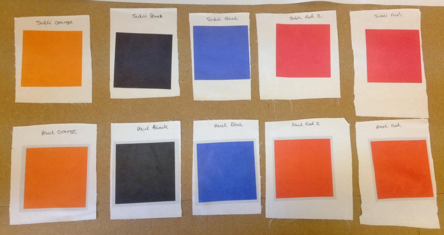

Done some test prints this morning and this is what I got. The red is redder in the profile that came with the inks but it's still a bit washed out, is that down to the fabric or the profile?
[ATTACH=CONFIG]2499[/ATTACH]

Re: Issue with Epson 7890 using sawgrass inks
Did you flush out the Epson inks with cleaning fluid, or just move straight to the sublimation inks? If the latter then it's not easy to know when the standard pigment inks have gone and you have 100% sublimation inks.
Yeah, flushed with cleaning carts. If there was some original ink left, would it now show on the blank as patches. I've run quite a bit of in through the printer so I would of thought any possible ink left would have past through now.
Most likely all gone now, but may have still been some old ink/cleaning fluid in the lines when you did the test charts for Paul.
