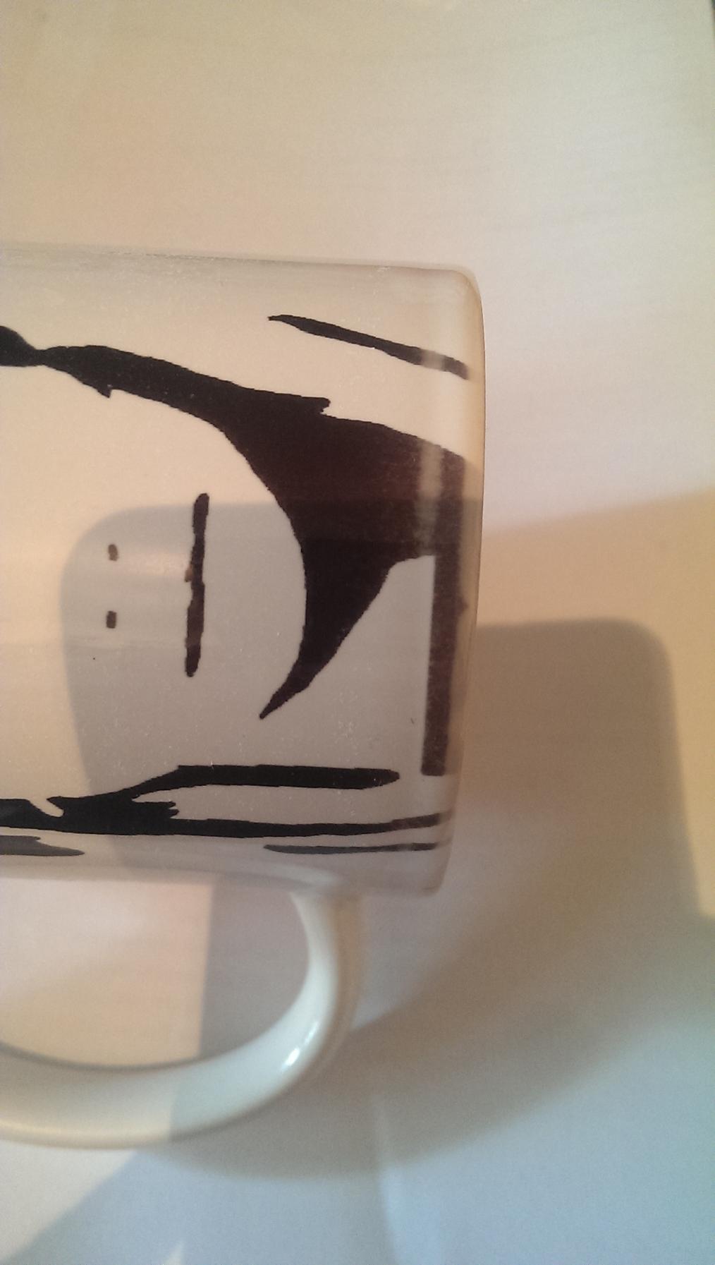

I have just bought a Coralgraph mug press switching over from using an oven and wraps.
I have not had any problems with the printer or paper and it's only happened since I've started using a press.
I can't get the mugs to press properly, can someone tell me what I'm doing wrong???
I'm doing 180/180 and have gone up to 240 seconds and 200 heat, I've also tried what feels like every combination in between!!*
I can't get the lower section of the design to transfer.
Any idea where I'm going wrong and how I can fix it?

Can you post a picture of a mug you've printed to show you're problem please.
The press needs to be nice and tight (and then a bit more) so that there is pressure from the blanket over the whole print area of the mug - you should see it depress around where the mug is, and you shouldn't be able to slide the mug around once the press is closed.

Hi,
I have tightened the pressure on the blanket so it wraps round with no room to move, the cup indents into the blanket.
I've been trying to upload a picture but for some reason it is not letting me upload. I'll keep trying

[ATTACH=CONFIG]2796[/ATTACH]
Here we go, basically the bottom cm.

Not sure if you mentioned it but whose mugs are you using? As mentioned, heating the bottom for 30 secs or so can make all the difference but not always necessary with good quality mugs.
Re: switching over from oven to press
I can see a lip on the bottom of the mug, that will be the cause of the problem, it is pushing the blanket away from the mug hence the band. Straighter mugs would solve the problem. A bit tighter may help.
