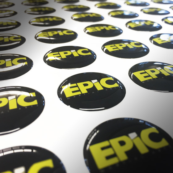

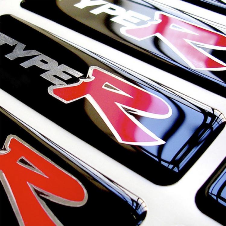

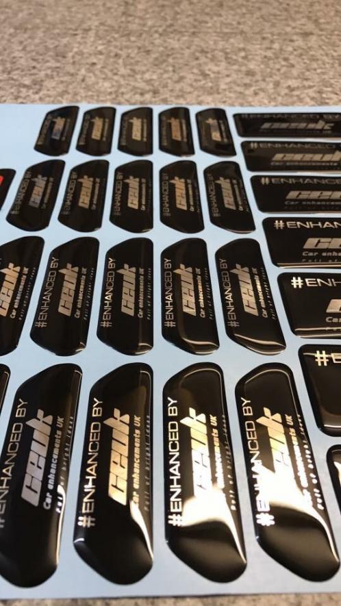

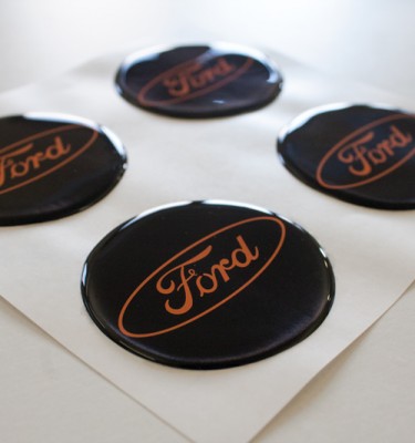

Hopefully someone can help I am considering doming badges for outdoor use but I am unsure as to what paper/media is required and also printer please advise?
I currently have a doming kit purchased from Liquid lens which I have used but not with good results as I always seem to get bubbles and may be printing on the wrong media type Inkjet media/Photo paper.
I have attached a few images of the types of badges i would like to make.

PS: At least one of them pictures you have posted will cost you a lot of ££ if you reproduce and they come after you, DMB will vouch for that one
