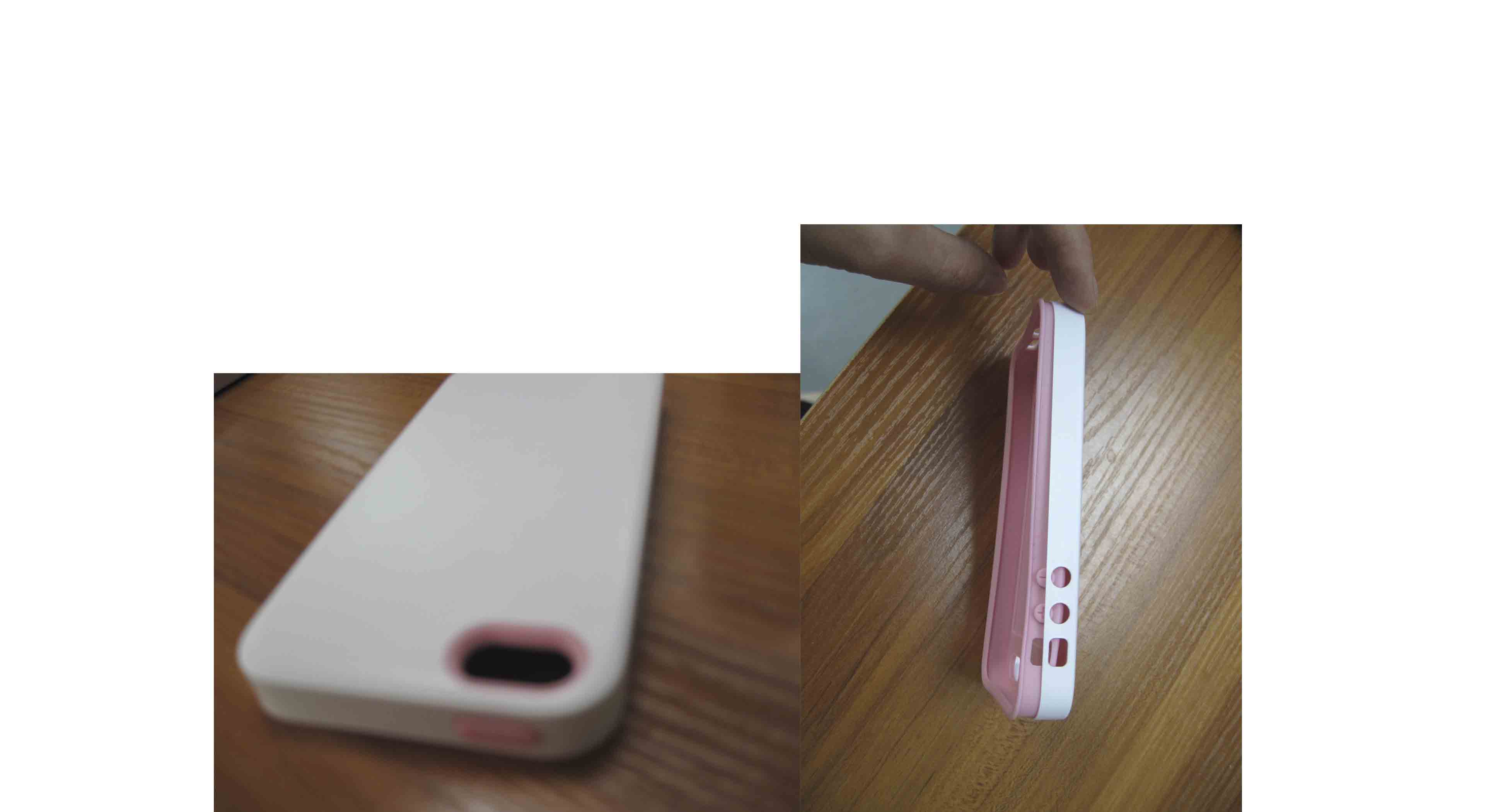

So i am getting a factory to produce custom phone cases for me which are of higher quality standard. I really hate the ones people are selling online and at suppliers. They are all for flat heat presses with the metal inserts. Here are some images of 1st samples produced
[ATTACH]1729[/ATTACH]
I have to order them in a bulk of 1000 each phone model (3 phones in my situation ergo 3000 cases T_T) Since i am a new starting business this will be pretty painful to buy. Was wondering if anyone would be interested in splitting the purchase with me (like you 100 cases). That way if my sales do go up i can always order more later. The inner silicon piece can be any color. Material outside is a something called RFS plastic which is apparently quite strong. Will probably cost around 1.2USD each case. Let me know if you are interested so i can send a sample to you (you pay for shipping and item cost!!! i'm poor!:mad:) Also just as a note, i won't say how much but it cost me more then $1.5k USD to make the mold for this case so you will definitely be saving if you share an order as i won't charge you for the mold making since it belongs to me T_T.
