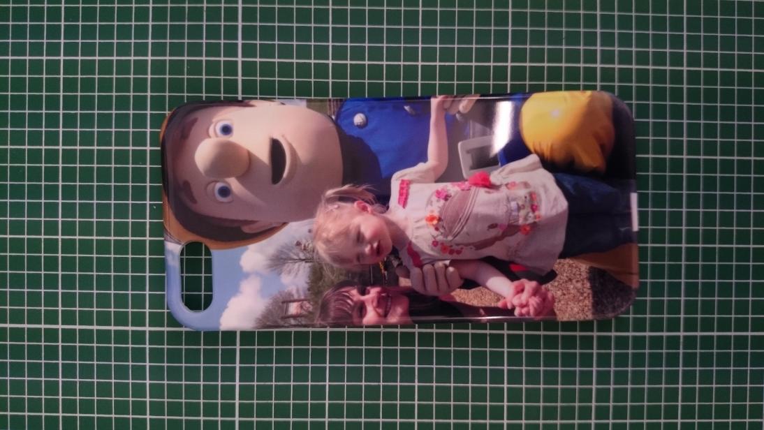

Well - Thanks for all your help. I think I've finally nailed it. test case #25 was perfect (see "goodcase1 attached)."
Pisquee, I did try your settings but unfortunately they didn't work - could just be my machine (pre-heating the puck fully really helped though).
It seems I just wasn't cooking them long enough.
Just in case it's useful for anyone in future here's my process. I've repeated it and so far so good.

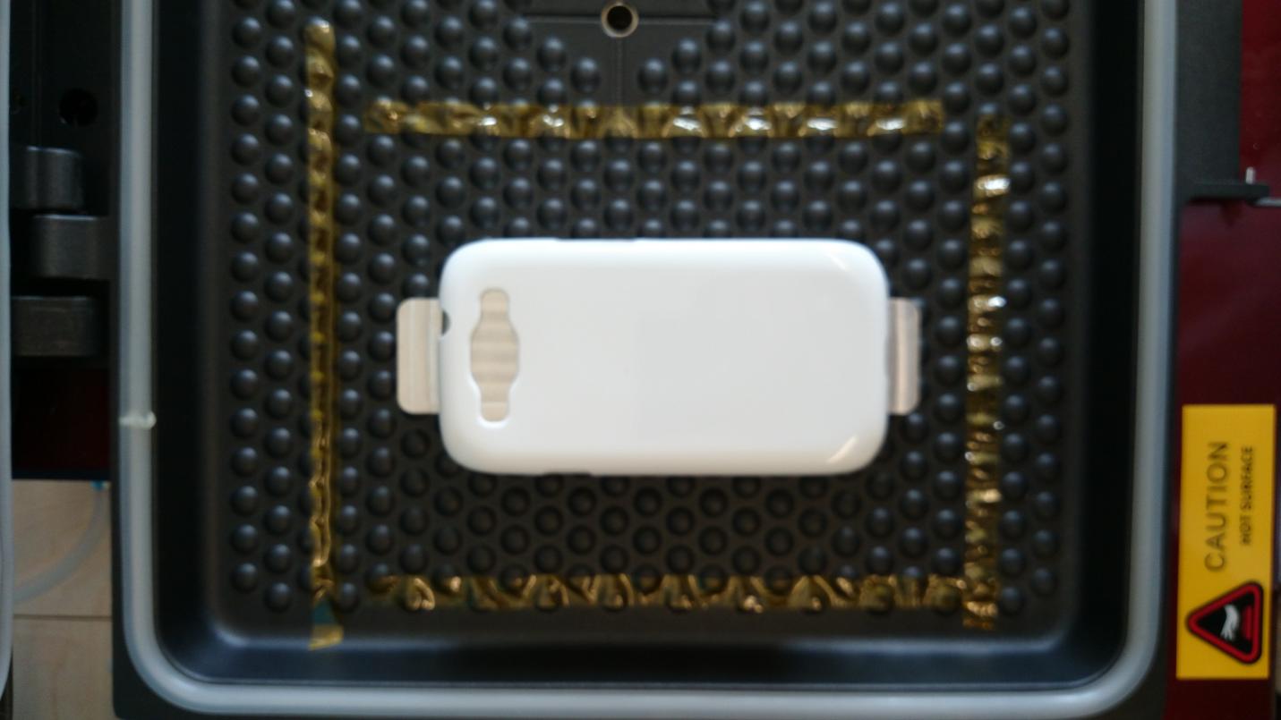

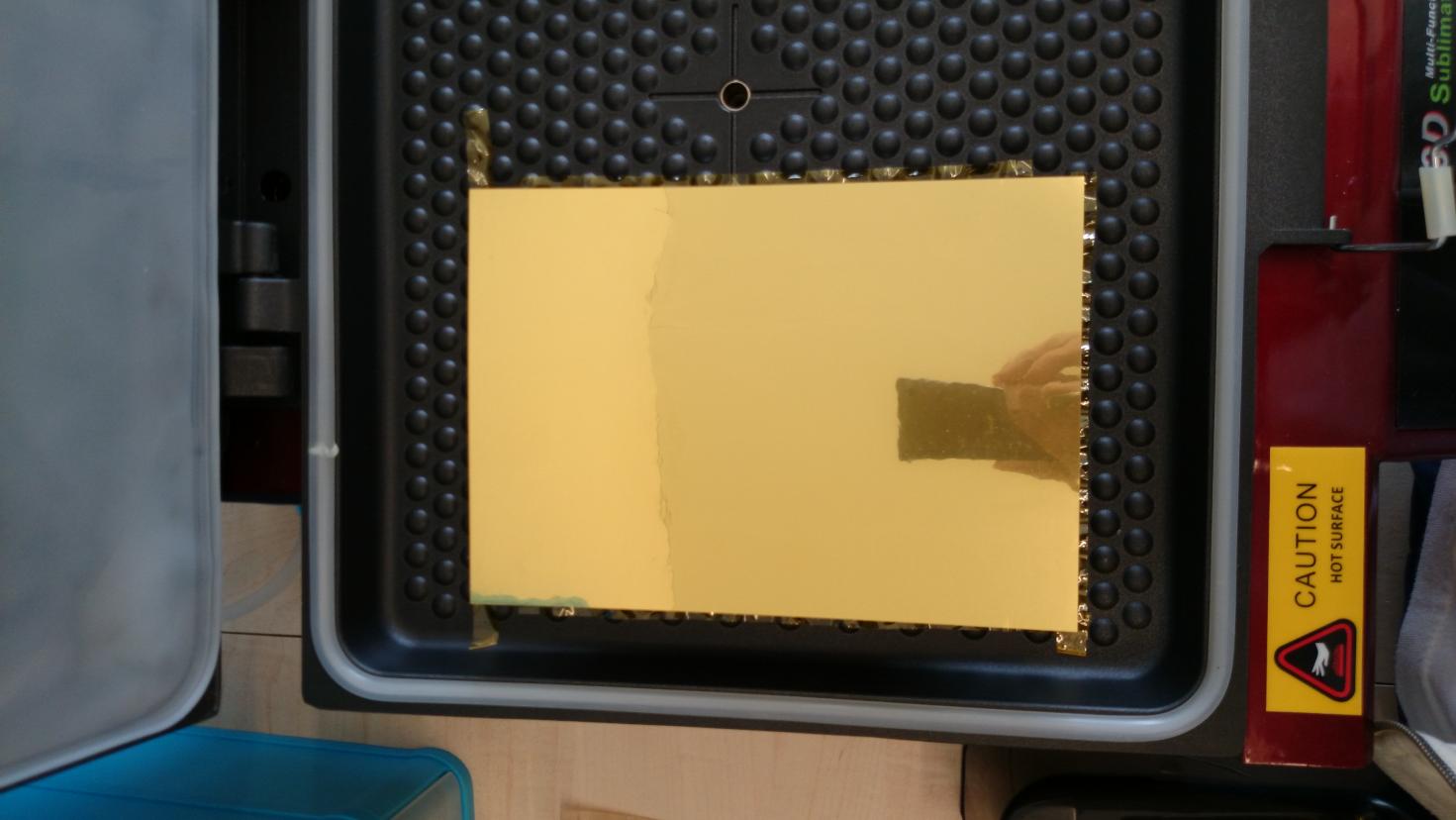

Hi cybalokz,
I've tried a few methods and here's what works best for me:
1) Mark out a template on base of machine using heat-proof tape making it the same size as your film (see template1).
2) place substrate/jig assembly in centre and lay film over the top so it lines up with your template (see template2).
3) close-up and away you go
I now leave this template there permanently so there's no faffing around when I want to make a case.
Cheers,
John.
There is a tool available but it's pretty clumsy and I was advised not to use it.cybalokz;85093 wrote:@Ucase Do you need a special tool to use film with the st3042, i have same machine but just use trupix paper at the mo? would like to try out the film
Cheers,
John.
- vB_ID:2507
- template2.jpg (84.29 KiB) Viewed 567 times
- vB_ID:2506
- template1.jpg (83.94 KiB) Viewed 567 times
