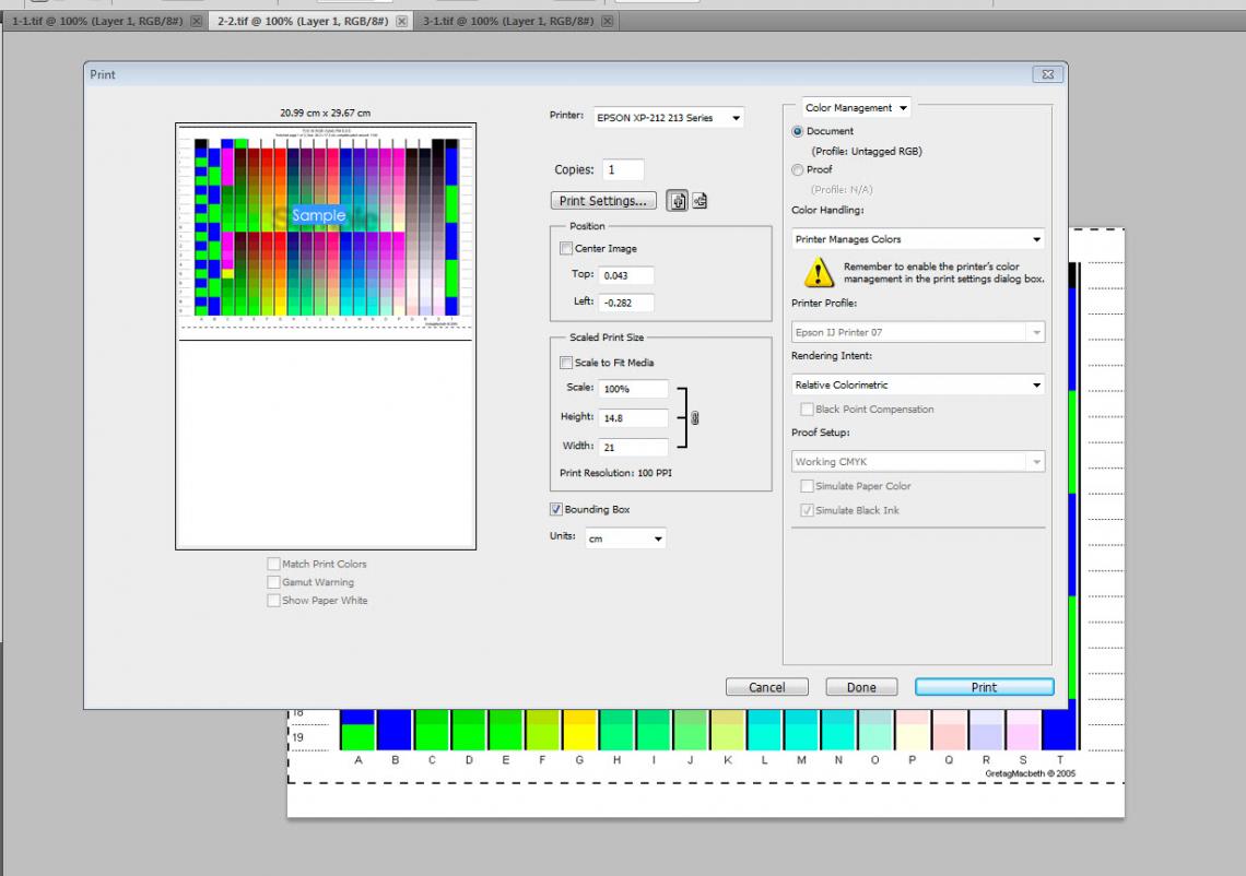

Cant seem to turn the No color management off in CS5, any ideas?
[ATTACH=CONFIG]2662[/ATTACH]
I'm trying to send you a message but your inbox is full.

Re: ICC Profile needed please
See here:GoonerGary;86757 wrote:You need to download the Adobe Color Printer Utility.
http://helpx.adobe.com/photoshop/kb/no- ... ssing.html
This prints the files from Paul without any colour management, but you will still need to make sure colour management is turned off in your printer driver, and make a note of any other settings you use (for the paper type and print quality) as the settings you have for the test prints will be the ones you need to use for your actual printing with the new ICC.
