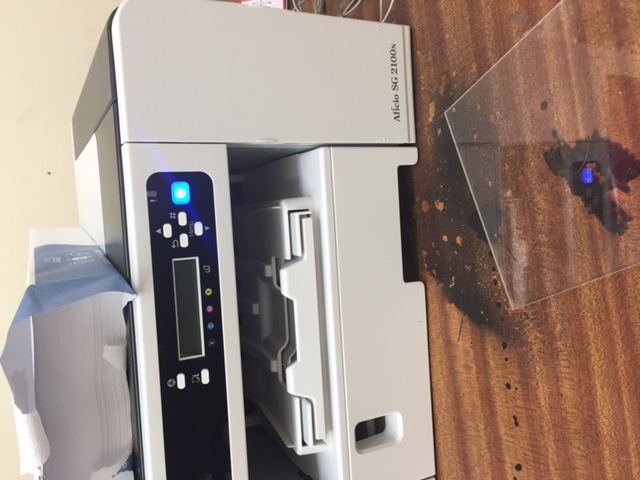

Hi everyone I'm new on here and new to sublimation printing on mugs and like most, I'm not getting it right at all. I need help.
This is my printer

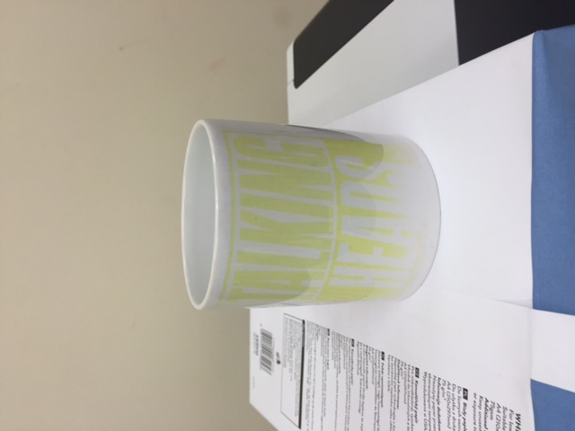

these are the results i'm getting
vB_ID:3776
vB_ID:3776

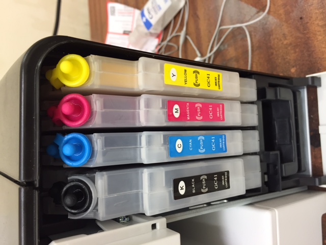

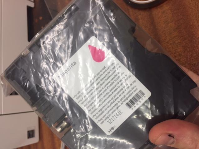

I've read a few things on the net about why this is happening ie times, paper I'm using etc. I did use the original ink that came with the printer which are these cartridges
vB_ID:3776
vB_ID:3776
and then I installed the sublimation cartridges. Maybe the old ink is still in there and needs flushing out?

Yeah I've more or less tried every suggested time and none have worked. I either get a faint outline of the image which just rubs off or this yellowy burnt image which I've photoed there.

these are my sub inks loaded
Re: What am I doing wrong?!
Just need to buy sublimation ink and you good to go. This is standard ink by the look of it.

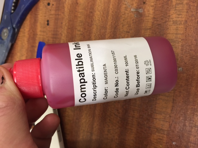

Paul;107074 wrote:Just need to buy sublimation ink and you good to go. This is standard ink by the look of it.
vB_ID:3778
vB_ID:3778
Hers's the ink the cartridges are filled with. It is sublimation ink
