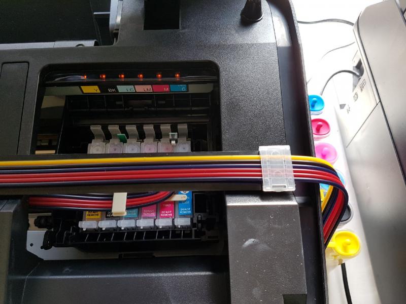

Yeah I've done all that .. waiting to get in touch with Inkexpress tomorrow to find out what else I can do, just thought I'd try you lovely people on here first. Will upload a pic for you to see.

Epson 1500W CISS.jpg (66.05 KiB) Viewed 657 times
This is how it came to me and after I installed it. As you can see the link lines are filled with ink.
Re: Epson 1500W install CISS fail
Same as mine. It' sounds like you've done everything, re-seated carts, pressed the button. Have you tried pulling the power lead from the back (whilst printer on) leave 5 mins and switch back on?

Justin;130539 wrote:Same as mine. It' sounds like you've done everything, re-seated carts, pressed the button. Have you tried pulling the power lead from the back (whilst printer on) leave 5 mins and switch back on?
Will give that a go .. thanks '' no difference'' sadly

you haven't pressed the carts in enough - I had exactly the same problem with my new one about 2 weeks ago. I was scared of breaking it. I phoned the supplier and they told me to give it a firm push using two hands. It is quite a loud click when in properly and then the lights go out and the printer starts charging.

loobyloo;130541 wrote:you haven't pressed the carts in enough - I had exactly the same problem with my new one about 2 weeks ago. I was scared of breaking it. I phoned the supplier and they told me to give it a firm push using two hands. It is quite a loud click when in properly and then the lights go out and the printer starts charging.
We have a winner, quite ashamed to say that this burly 6'4'' bloke hadn't done exactly that. Sorted now .. thank you so much :redface:
