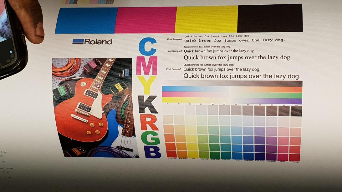

Hi guys ..Can we change the print head with out a tech ??..Is it doable ?...my sp300i need a dx4 head as the black is not perfect ..Just thought to do it my self ..Any advice ?

I managed to change a head and I think its successful , I couldn't find a techie that could fix it asap so I did it my self .I was bit nervous but just gave it a go .Took about 2-3 hrs including head alignments so not too bad as these days business a bit quite too lol, Got a great support from Scotty
too ..Its firing all the nozzles now :biggrin:..I think it needs a very small adjustment you can only see on the really small fonts but will deal with it later ...
