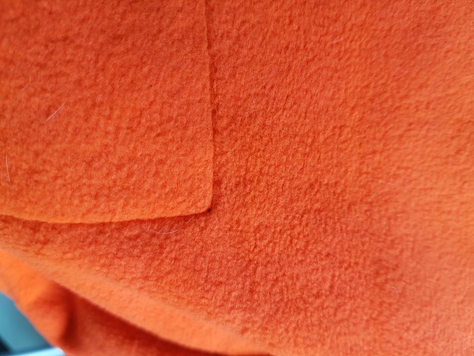

I think my only option will be to embroider as heat pressing is going to flatten the fleece as mentioned by justin.

- 20200626_183305.jpg (95.63 KiB) Viewed 2935 times
Re: Vinyl on Fleece?
I agree, that weave looks pretty “loose” and, like you have said, it will flatten.
