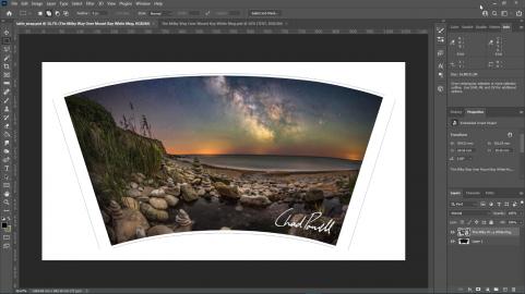

I bought a handful of 12oz Latte Mugs to have a play with, and tried my best to make a PSD file where the design follows the shape of the mug without distorting once printed. The design I made is fairly good and gives me 100% coverage (Attached here if you want to download it) The top half of a design seems to be stretched quite a bit but I'd like something that gives a perfect representation when printed. If anyone could share, it would be mug appreciated!

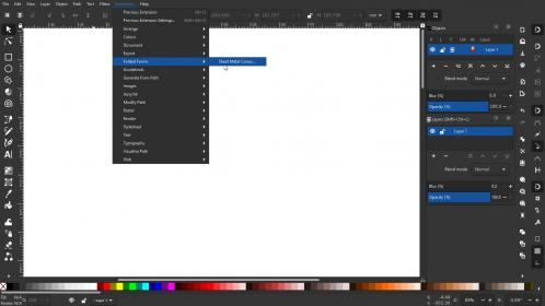

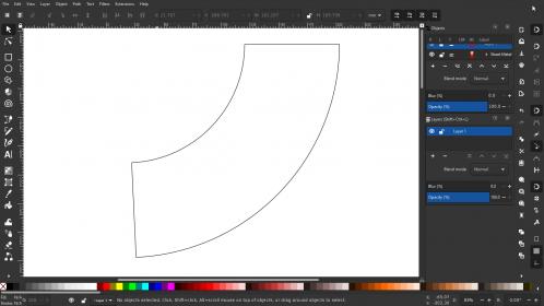

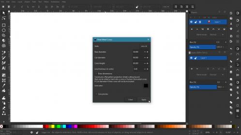

Depending upon how deep you want to go into this, you can use Inkscape (Free) to produce unrolled truncated cones of any size with this extension.
I've just tried it out with some made-up settings off the top of my head and this is what it produces ...
[ATTACH=CONFIG]7311[/ATTACH]
[ATTACH=CONFIG]7310[/ATTACH]
[ATTACH=CONFIG]7309[/ATTACH]

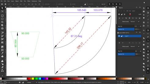

Checking the 'Dimensions' checkbox in the dialogue adds dimensions to the drawing.
[ATTACH=CONFIG]7312[/ATTACH]
Once finished, you can easily save and import into Photoshop or whatever for further processing and image warping.

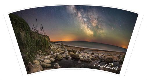

[ATTACH=CONFIG]7314[/ATTACH]
Once embedded into the smart object, the horizon appears lower, with the sky taking up 3/5ths of the image.
[ATTACH=CONFIG]7315[/ATTACH]

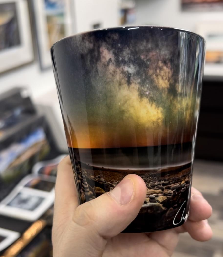

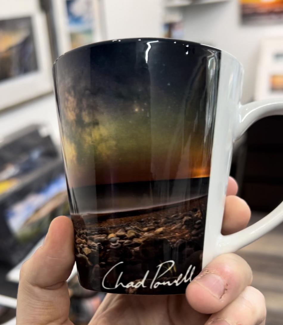

Once printed onto the mug, the horizon is still not in the centre, and it swoops upwards on the right hand side. I'm looking for a PSD file that will accurately warp an image and retain it's form.

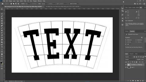

Re: Request: 12oz Latte Mug PSD file with Smart Object Warp
After placing the image into the Smart Object, did you then use the Warp Tool to warp the Smart Object layer?

You'll notice that the horizon line stays at a constant height over the whole of the mug wrap and should thus be centred around the mug when pressed.
